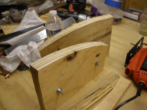

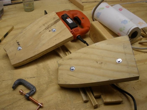

nose rib blank forms
cut out two sets of plywood forms for the nose rib sheet metal cutout using router laminate trim bit. after I pick one of these for that purpose, I will cut down the other one for use in actually forming the rib flanges.
