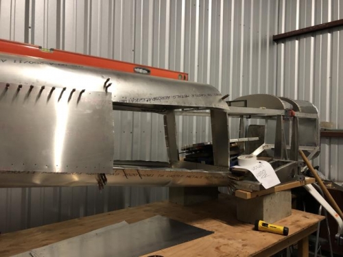

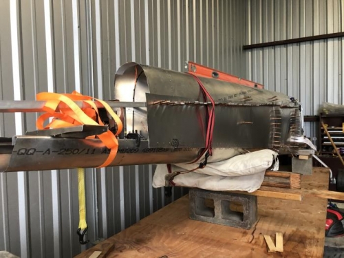

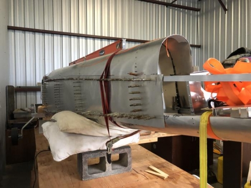

planning F 11 and F 12 installation
Checked fit of side skins and took measurements for making longeron shim to correct twist in aft fuselage. will need to make an additional F 10 and an additional F 11 plus remake F 12.
