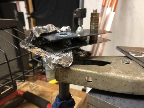

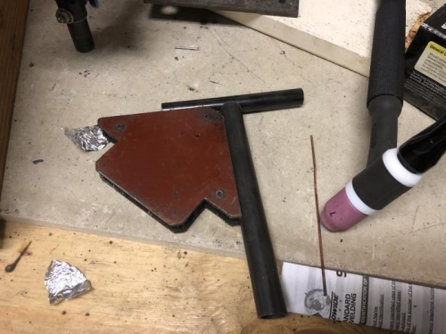

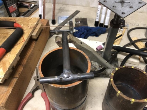

Brief Description:  Welding on rudder pedals and belcrank
Welding on rudder pedals and belcrank for activation of elevator push-pull rod. The aluminum foil around the belcrank is an argon dam to hold the argon in place around the control rod because I had to extend my tungsten to an excessively long stickout to reach inside for the last weld.
