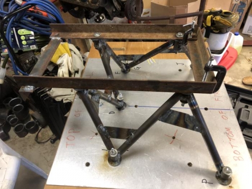

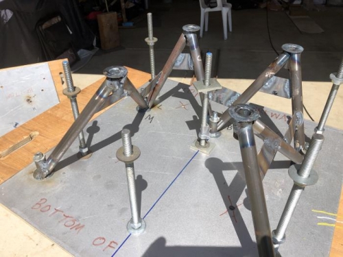

Brief Description:  modified assembly jig and continued welding MM2.0
Removed the engine side of my assembly jig, cut angle iron pieces to hold the standoffs in alignment. Bolted the standoffs to the angle iron to hold them rigid to avoid distortion while finish welding. Continued finish welding, alternating locations around the mount. Between the more open fixture and the hood/goggles to allow getting inside, I have much better access now for the finish welding. Got a few more welds done today, if I get a reasonably early start tomorrow I have a reasonable chance to finish this mount tomorrow.
