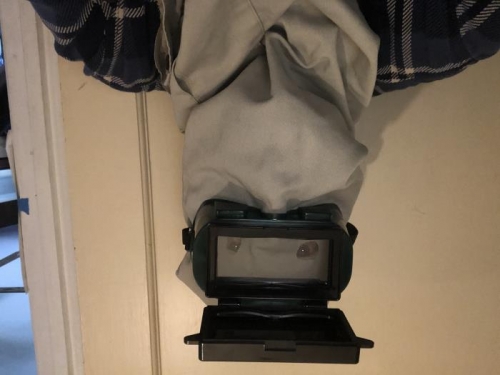

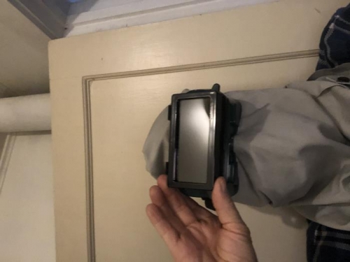

Brief Description:  developing confined space weld techniques
