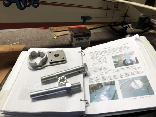

Brief Description:  Wheels and axels

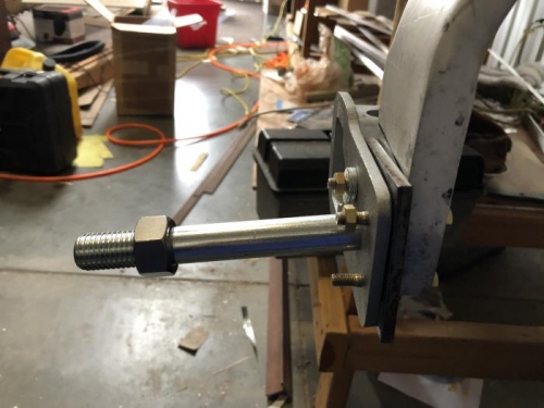

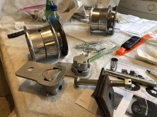

Received the wheels, tires, tubes,brake master cylinders and installation parts. Reviewed the installation instructions that came with them, noted that the order of stacking the parts on the gear legs are different between the Thatcher plans and the O'Keefe / G. P. default instructions. This is not necessarily a problem, just something to keep in mind as the project proceeds. The caliper holder/mounting plate came as a raw casting which I will have to finish for my custom installation. The hole in the center is not quite big enough for the axel bolt to fit through, so it will have to be up-drilled. Holes for the AN4 bolts to mount it to the gear leg also need to be drilled. As received, the calipers do not fit properly into the caliper mounting plates. I am going to need to do some grinding on the inside surfaces of the mounting plates and the outside surfaces of the calipers to get them to float together properly.
