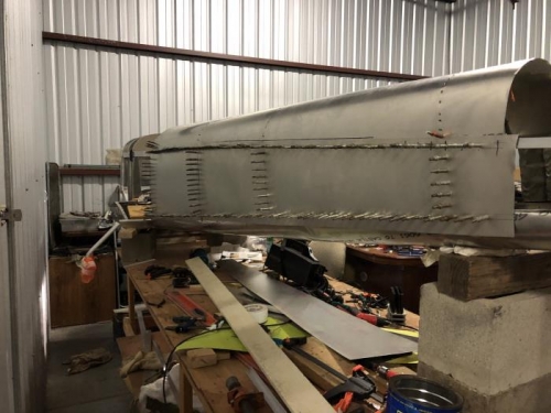

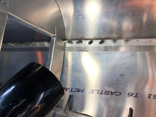

Brief Description:  finish fitting aft left side fuselage skins

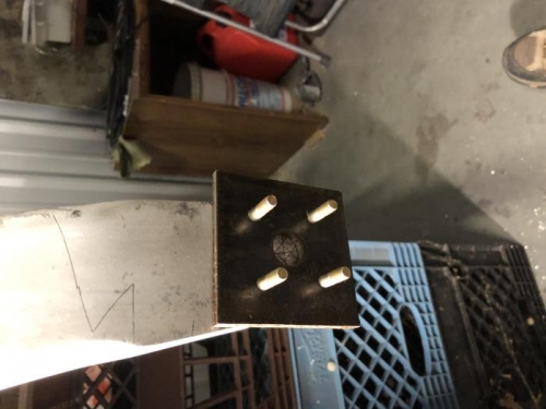

finished up the initial fitting of the left side aft fuselage skins. At this point they are clecoed with 3/32 inch clecoes because I am running short of 1/8-inch clecoes. so at some later point I am going to have to updrill all those holes to 1/8 and deburr them before rivetting. I am going to have to either buy more clecoes or finish rivet one side. For now, leaving it like this and moving on to the landing gear. I will be using wheels, tires and brakes from O'Keefe (formerly Great Plains) on my Grove landing gear, which means I have to fabricate my own axels since the bold hole patterns don't match up.
