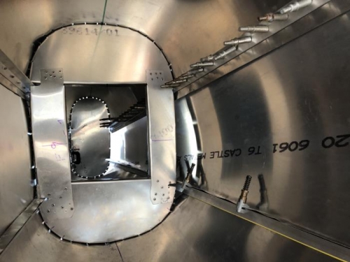

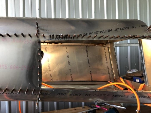

Brief Description:  left side aft skin on fuselage
Started fitting the 0.020 skins to the aft fuselage on the left side. In order to do this, had to remove the skins from the right side (one at a time) to allow access for back-drilling the rivet holes through the longerons. This is going much better on the left side than it did on the right side.
