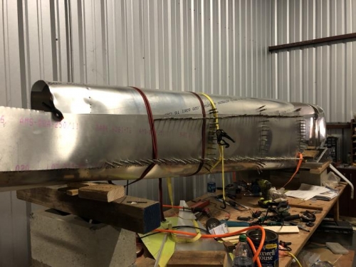

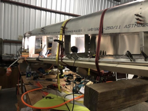

Brief Description:  right side aft fuselage skins
Finally got the 0.020 skins fitted to the right side, first with 3/32 clecoes and then updrilled to 1/8 clecoes. Quite a struggle to get skin pulled into fit to bulkheads. Looking forward to seeing if I learned enough on the right side to make the left side go easier.
