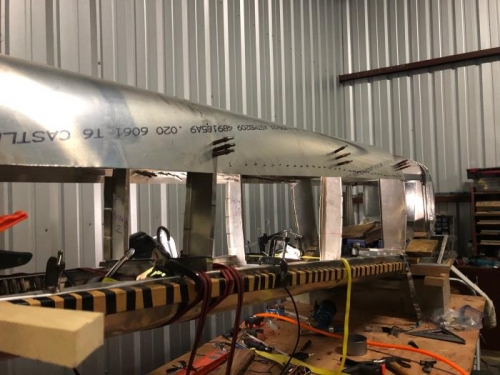

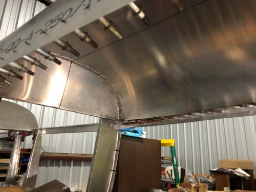

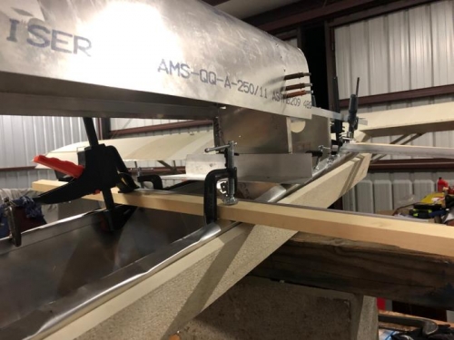

Brief Description:  continuing to fit aft fuselage skins
continuing to work on finalizing the fit of the top and bottom skins on the aft fuselage. On the top skin, started drilling and clecoing the attachment of the skin to the longeron. On the bottom skin, forming the flange and cutting the slots into the bulkheads to provide clearance for the flanges. This is tedious work involving a lot of pulling things into position, marking areas to cut, then disassembling and making the cuts. probably need another 8 or 10 hours to get these top and bottom skins finalized. then it will be fitting the side skins.
