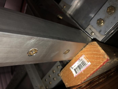

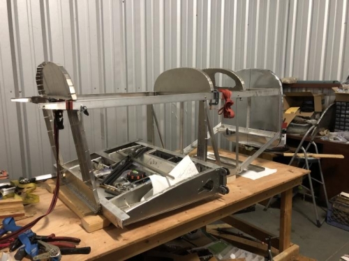

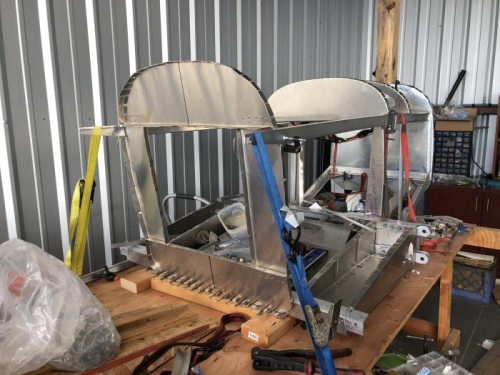

Brief Description:  seat back rivetting, gusset bolting, machine screw
Rivetted the seat back (Bulkhead F6) to the rear of the center section, Installed some of the cap screws I'm using to attach forward longerons to angles on back of firewall. Installed the countersunk machine screws holding the reinforcing bar for the landing gear to the lower longerons. removed the bracing and strapping that had been holding the forward fuselage in alignment. nice to see it in a self-supporting condition.
