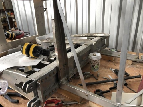

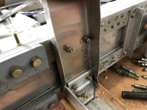

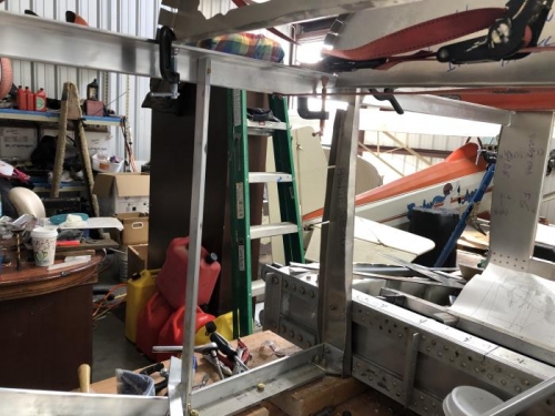

Brief Description:  completed installation of F5 bulkheads
Got the F5 bulkheads fastened to the center section main spar, lower longerons and upper longerons. Took awhile to fit them but once in place they look good. Noted a problem with fitting the F3 bulkheads. Looks like the F3 Bulkheads are supposed to extend through the notch where the lower longerons are bent, and in order for them to do that the vertical angle at F3 has to align exactly with that notch, and as of now mine don't. Need to check all my measurements and see whether to move the angle or the notch. Still struggling with fastening the gussets at firewall / longeron junction.
