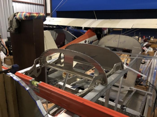

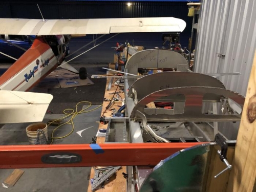

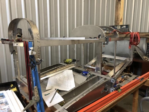

Brief Description:  bolt upper longerons to firewall, install angle at
Bolted upper longerons to angles on aft surface of firewall. clamped in place the instrument panel (F4) and bulkhead F2. Installed vertical angles at F3 location. Used ratchet straps to align longerons.
