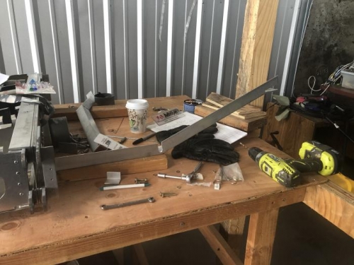

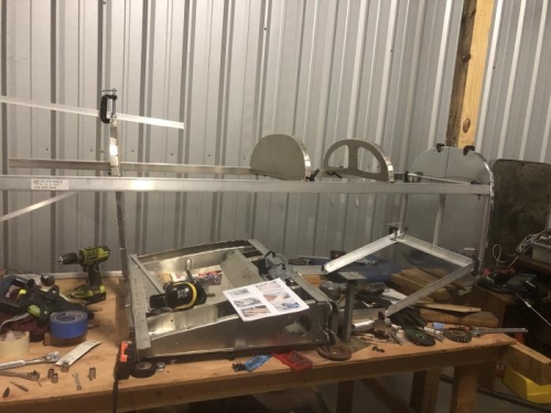

Brief Description:  lower longerons attached
added a couple more stiffeners to the firewall, then fabricated the longeron feet and attacheded them to the center section. clamped the forward end of the longerons to the firewall. verified the 30 inch distance from center section to firewall per plans.
