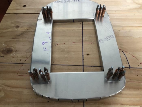

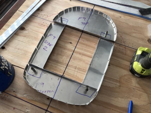

Brief Description:  forming and assembly of bulkhead F9
Finished forming the four components of bulkhead F9: top, bottom, right side, left side. Then assembled it over a truing grid drawn on the assembly table per the plans. first clecoed it to the table using 3/32 clecoes. then removed it from the table, updrilled all holes to 1/8, deburred all holes, reassembled and rechecked squareness of the assembly against the grid on the table. Ran out of time, leaving the final rivetting for tomorrow.
individual components being formed
initial assembly using 3/32 clecoes
1/8 clecoes in place after updrilling
