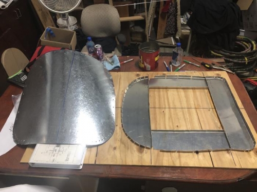

Brief Description:  forming and fabricating bulkhead F6
Drilled holes through the forming blocks and aluminum blanks to mark location of slots. Then took the aluminum out, re-joined the forming blocks, cut off flanges at the bend lines, then separated the forming blocks to sand the radius on the edge of the block. then re-joined the blocks with the alumium blank between them and bent the flanges. then laid out the top, bottom and both sides on assembly table marked with a grid according to the plans. Rivetted the parts together, and there is my bulkhead F6.
the bottom quadrant of F6 in its forming blocks
all four pieces of F6 formed and ready for assembly
the assembled F6 bulkhead alongside the firewall (F1)
