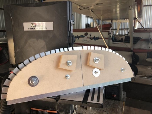

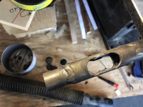

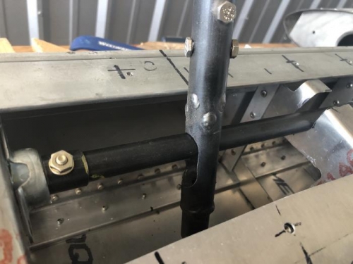

worked on two different items today. Got Bulkhead F2 formed, but left it in the forming blocks until I can find my jigsaw to cut out the instrument access holes shown on the plans. also finished cutting the slot in the bottom of the control stick, where it pivots around its mount on the elevator control tube.
Bulkhead F2 in its forming blocks
the two 5/8
the two 5/8" holes that start the slot for the elevator tube
the control stick set in place on the elevator  control tube
