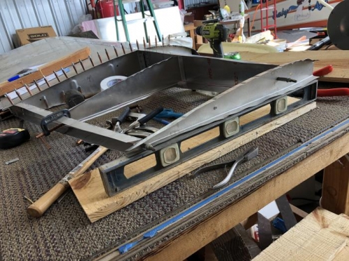

riveted right wingtip spar to right main spar
Clecoed the main spar and wingtip spar together, then clecoed the wingtip aft spar into place and attached the wingtip mid rib and wingtip tip rib.
using a steel T-setion to hold spars aligned while drilling and clecoing
begin framing up the right wingtip
need to hold wingtip rib level while fitting skins, trailing edge and leading edge.
