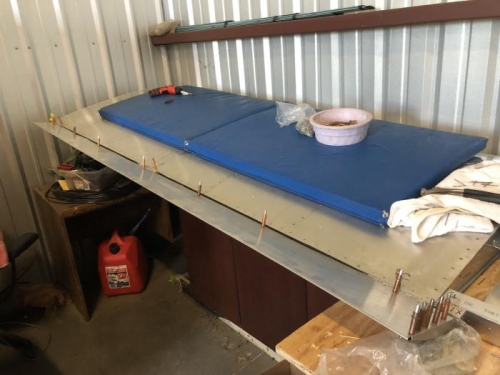

Brief Description:  left aileron completed and hung on wing
disassembled aileron, deburred all edges and rivet holes. Installed minimal clecoes to all for final adjustment and alignment check of hinges. completely installed all clecoes. Finished final riveting on aileron and hinges.
final adjustments to hinge alignment

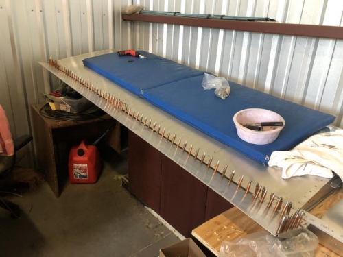

fully clecoed, ready to rivet.
all aileron riveting complete
