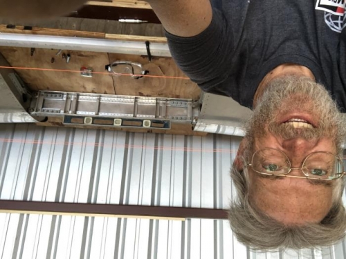

Brief Description:  installed aft spar carry-through

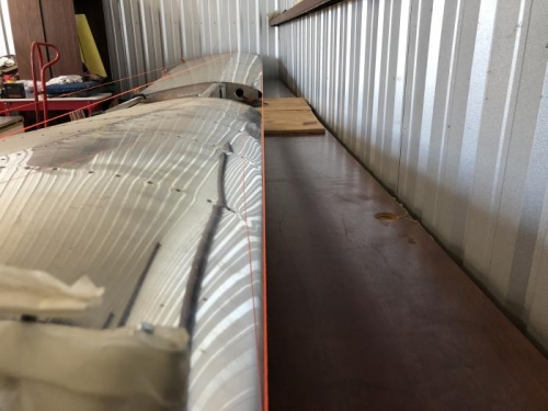

installed the aft spar carry-through. aligned wings using fluorescent masonry twine, which came out looking like lazer beams in the photos. that looks kind of cool. I installed it temporarily with 3/16" machine screws. after I am sure everything came out square I will ream those out to !/4" per the plans.
align wing spars with center spar carry-through
align wing leading edges
