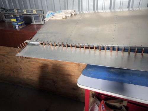

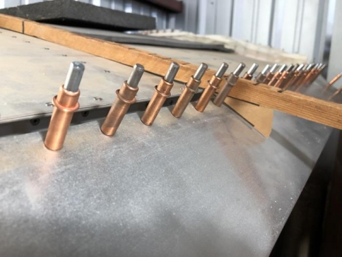

Brief Description:  hung right aileron on right wing
Installed aileron hinges per instructions, center rivet only on each hinge at first to insure correct alighment and smooth, bind-free operation. Used a cardboard template to verify adequate clearance for downward deflection. updrilled all holes to #30 drill for 1/8" rivets. For now, I removed both ailerons and stored them in clecoes, next step will be disassembly and deburring all holes. going to defer that to a later time, and move on now to the fabrication of the fuselage center section.
aileron hinge installation
alignment of the aileron hinges
