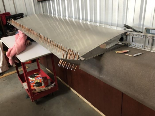

attached left aileron to left wing
fitted the left aileron, still in clecoes, to the left wing. Looks good, I am happy with the fit, so next step will be deburring all the holes and riveting the aileron and hinges.
left aileron in neutral position
left aileron at max downward deflection
upward deflection of left aileron
