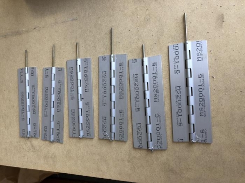

drilled holes in aileron hinges for retention of hinge pins. also cut out aileron control horn blanks

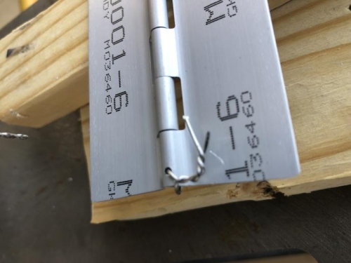

aileron hinges drilled for safety wire
safety wire to retain hinge pin

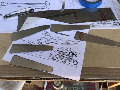

aileron horn blanks cut out
