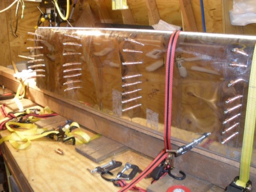

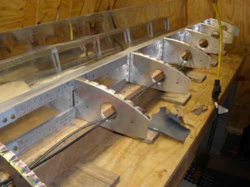

Brief Description:  up-drill holes in skin and ribs
After the skin and ribs were drilled together using a 3/32 nds drill bit, I went back over the entire assembly and enlarged the holes with a # 30 drill bit. Then I dis-assembled them, deburred all the holes, and re-assembled the skin to the ribs.
