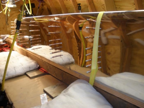

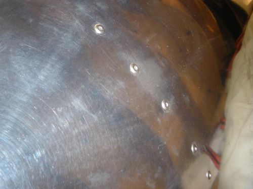

Brief Description:  Enlarge rivet holes and begin riveting
