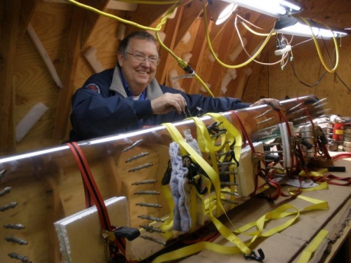

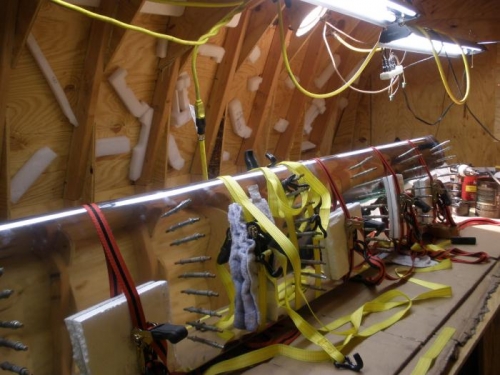

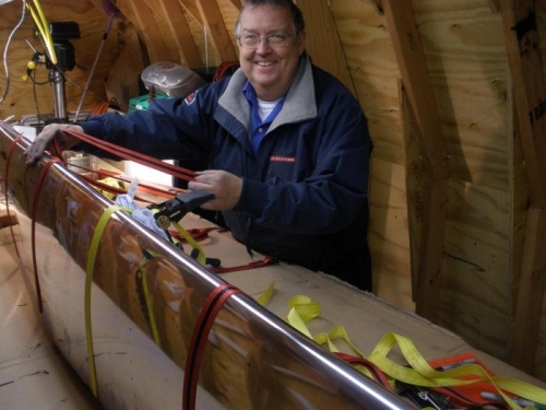

Brief Description:  Drilled and clecoed upper surface LE
I drilled and clecoed all the ribs on the upper surface of the leading edge skin on the right wing. Now I have a pretty big bubble in the bottom surface. Looks like it was a mistake to drill and cleco the ends first. Probably would have been better to just clamp them and work from center rib outward to do actual drilling.
