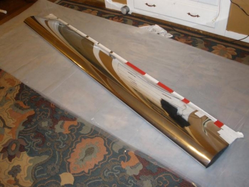

Brief Description:  Vacuum forming complete

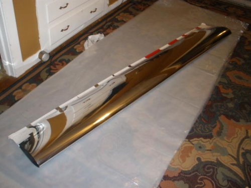

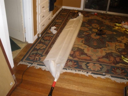

Image number one shows the assembly with vacuum applied. one of the interesting things was that it was not necessary to tape the entire length of the plastic, as I did with the first bend. This time I just pressed the film together with the vacuum running, and the external air pressure caused it to seal. Images 2 and 3 show the finished product.
