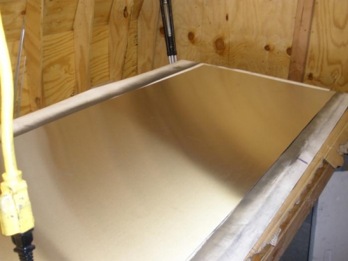

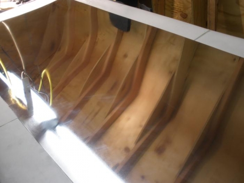

Brief Description:  Polish wing leading edge
This is the polishing process on the second wing leading edge. Image 1 below shows the skin before polishing, Image 2 shows it after four passes of compounding with Nuvite F9, and Image 3 shows it after 2 more passes with nuvite "C" grade polish. Next Log entry shows final result.
