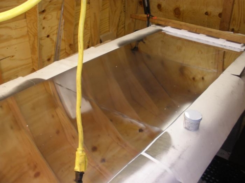

Brief Description:  polishing wing leading edges
It took me 8 hours to do just one leading edge skin. I did four passes with the F9 polish, two passes with the "C" grade polish, and then two passes with the "S" grade. Image 1 below shows the process partway through, and images 2 and 3 show the finished product. The mirror finish reflects the ceiling of my gambrel-shed workshop pretty well.
