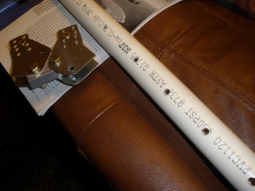

Brief Description:  leading edge skin bending prep
I bought a 10-foot pvc pipe with 1.25 inch ouside diameter (5/8 " radius) and drilled holes in it every couple inches. This will be the centerpiece of my attempt to vacuum-form the leading edge skins. I also have some plastic film, duct tape, and a couple vacuum cleaners for this, which will be my first attempt at vacuum forming.
