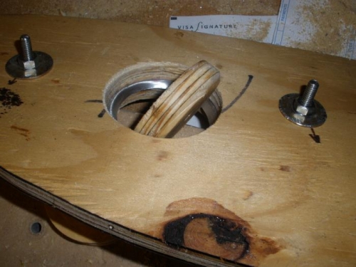

flange lightening holes in 9 nose ribs
I used the plywood form blocks and a rounded plywood plug to stamp flanges around the lightening holes.
