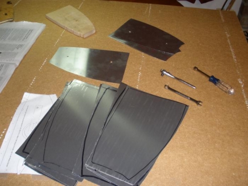

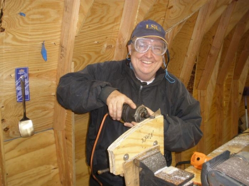

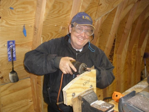

Brief Description:  final shaping of nose rib blanks
I took the rough-cut nose rib blanks that I cut out on 11/9 and trimmed them to final shape. I used the technique of sandwiching them between plywood shapes and using a laminate trim bit in a router to make my 18 identical blanks.
