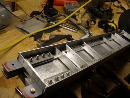

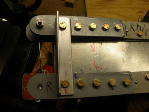

Brief Description:  left wing dihedral setting
I completed setting the dihedral on the left wing spar. This included drilling and bolting the bottom 4130 steel attach plates on the center section. I still need to step drill the quarter-inch pilot holes up to one-half inch for the wing attach bolts.
