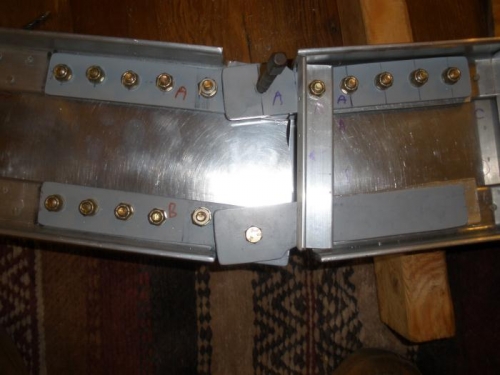

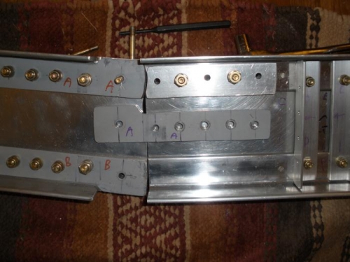

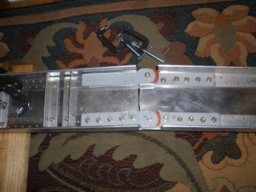

Brief Description:  clearance adjust at wing root
I needed to make a lot of adjustments at the wing root on the left side before I could begin to set the dihedral on that side. I had to round the corners of the wing spar, trim the spar web, and grind some rounded recesses into the center section end in order to get the left spar and center section to mate together properly.
