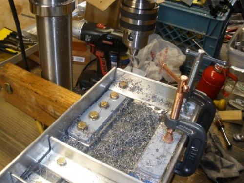

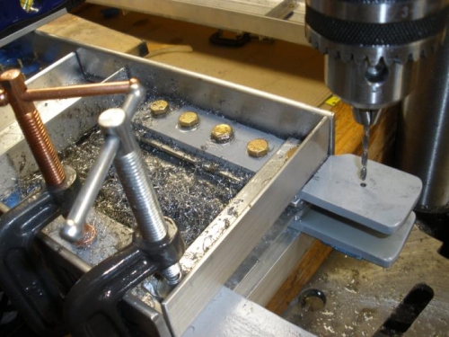

Mark Weitkamp CX4
Date:  10-13-2010
Number of Hours:  4.00
Manual Reference:  plan sheet 1
Brief Description:  steel work on center section
I finished drilling and bolting the 4130 reinforcing plates on the upper right-hand corner of the center section spar carry-through. And I drilled the wing attach bolt holes out to one-quarter inch diameter, half-way to their final size of half an inch.
