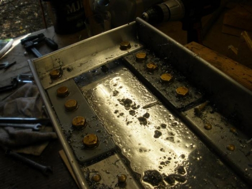

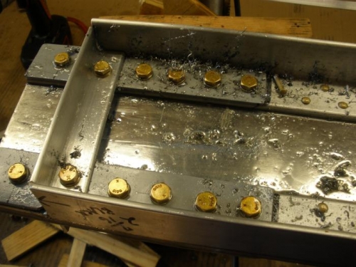

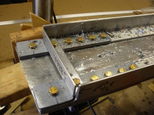

finish steel work on left spar
I finished drilling the holes and bolting on the 4130 reinforcing plates on the left spar. Next step on this spar will be disassembly, deburring, and pre-drilling the rib attach holes in the rib attach angles.
