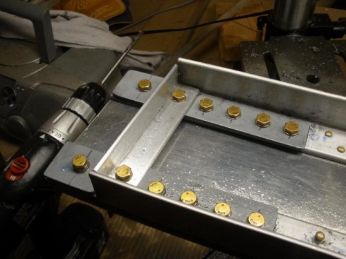

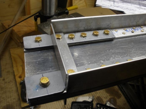

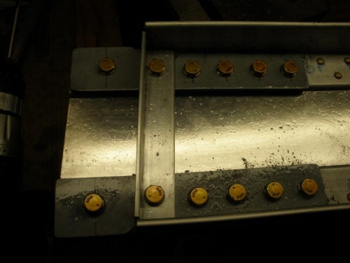

finish steel work on right spar
I finished drilling and reaming the quarter-inch holes for the AN-4 bolts to hold the 4130 steel reinforcing plates on the root of the right wing spar.
