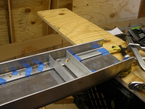

Manual Reference:  plan sheet 1

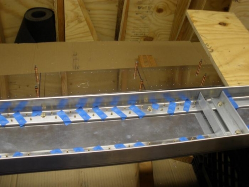

Brief Description:  match drill rib attach angles for center spar
