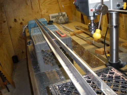

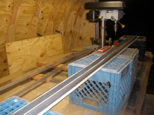

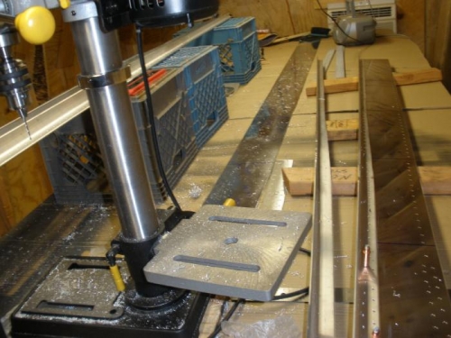

Brief Description:  layout and predrill rivet holes in right spar caps
I decided to transfer the rivet hole layout from the spar caps of the left wing, onto the spar caps of the right wing. I drilled the initial, "locating" holes at 7/64 ths of an inch. Next I'll drill them out to number 30 when the spar caps, webs, and reinforcing plates are assembled together.
