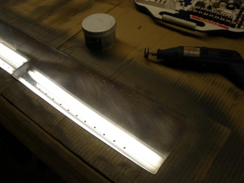

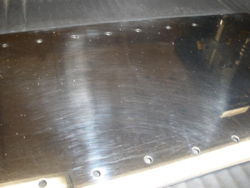

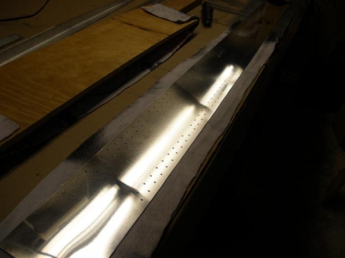

Brief Description:  still polishing out the big bad scratch
I keep going back and forth between being frustrated that this is such a slow process, and being amazed that it actually is working, though agonizingly slow. The scratch is very slowly fading away, as the area around it becomes more and more like a mirror. So far I have just been using the grade F9 Nuvite. If I do manage to completely remove the scratch, I may finish up that area with the grade C and Grade S, according to the instructions I got from Sonex with my polishing kit. It does look pretty hopeful that I will be able to save this spar web.
