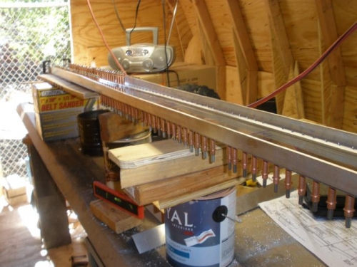

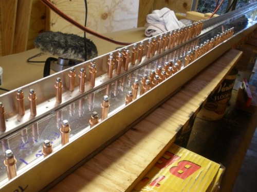

Brief Description:  finish drilling and clecoing rivet holes in left s

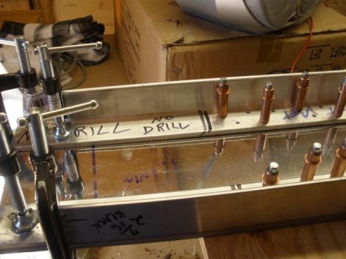

I finished drilling and clecoing the rivet holes in the left spar. One of the things I learned was that the layout for where rib attach angles and other fittings go needs to be marked on both sides of the web. This is becausel after the holes in the first 30 inches are done, with the 2024 bar backing, it worked best for me to flip the spar over so I was drilling through the web first, and then into the cap.
