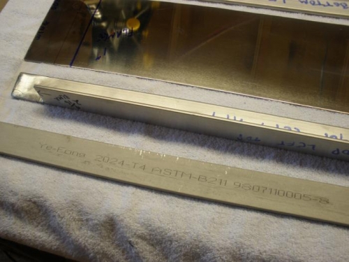

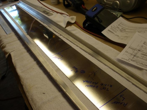

Brief Description:  more spar cap finishing
I ground and polished down the area on the spar caps where the fillet between the two legs of the angle meet, so the 4130 reinforcing plate will have a flat place to sit. I polished out some scratches in the spar webs in preparation for assembling the spars tomorrow.
