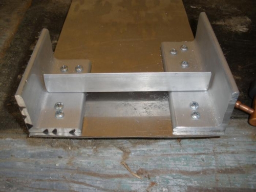

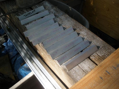

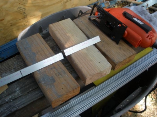

I used the assembly jig previously made, to build a short section of wing spar simulator, to get an Idea of how the wing rib attach angles will fit, and how long they need to be. Then I cut out 26 angles, each 3/4" x 3/4" x 0.062" and just slightly longer than five inches. These are just the rough cuts, these parts will need to be deburred later.
