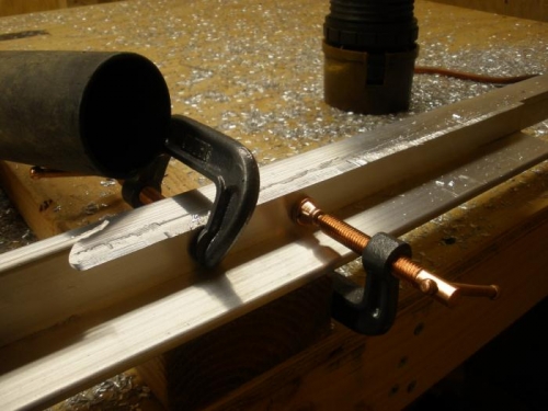

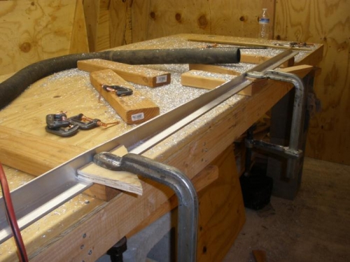

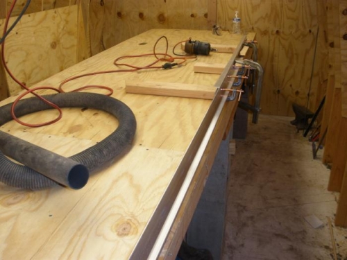

fifth taper cut on spar cap
made fifth taper cut using router and two fences, one for the straight cut and a second for the tapered portion. it is still not clear to me whether this works out better with the jigsaw or the router.
