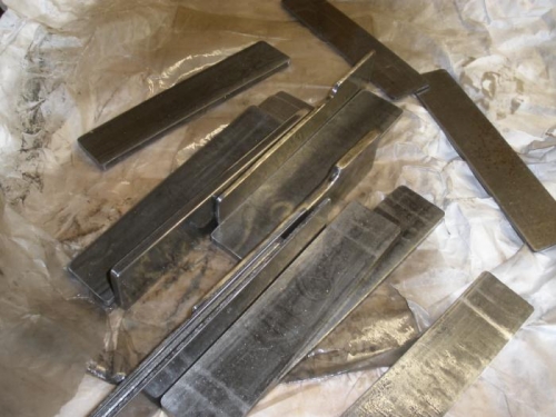

Brief Description:  4130 steel for wing attach fittings

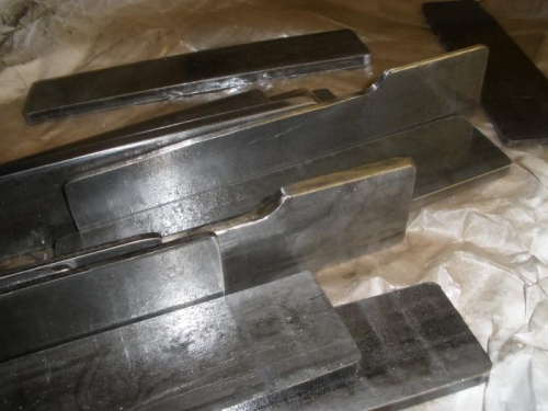

Rough cut out 16 pieces of 4130 steel, 8 of them 1/8 in by 7 in by 1.5 in, and 8 of them 1/4 in. by 7 inch by 1.5 in,. for wing attach fittings. On two of them I made the cutout for clearance of the spar cap, need to make that cut on six more. All need some more edge treatment and general polishing before these will be done.
