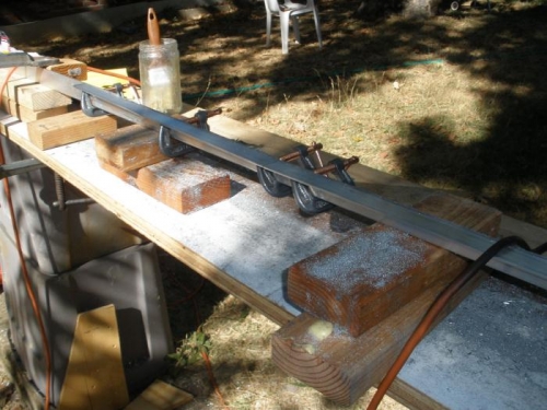

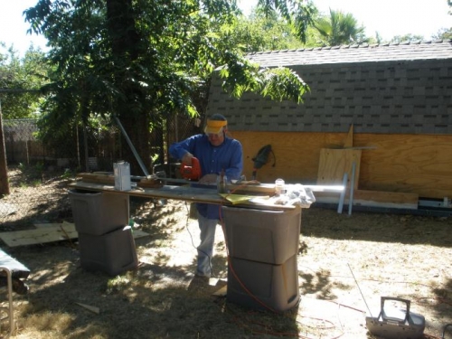

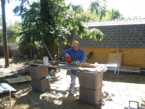

Brief Description:  fourth taper cut on spar cap plus spacers
bought a new, stronger jig saw which did a better job of cutting, and followed it up with a pass using the router with angle guide. also cut the one-eighth inch spacers for center section spar carry-through that I forgot last time. I need to remember that there are parts shown once on the plans that are typical of multiple other places. The last time I cut out those spacers I cut out everything I saw, but forgot that there is a mirror image on the bottom of the spar carrythrough that is not shown on the plans. also used the polish wheel to get a pretty decent finish on some of the cut edges.
