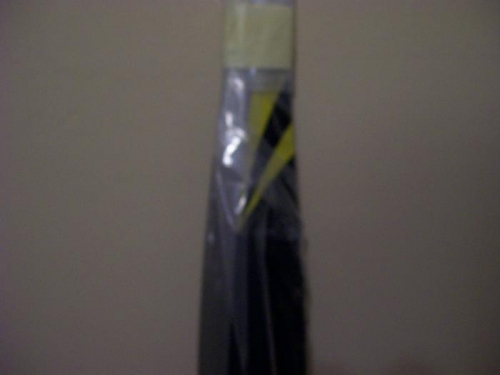

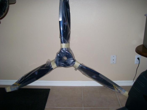

Received my Catto three blade prop yesterday. I was happy it showed with no damage. Left it wrapped in plastic since it will be going to the airport in a few weeks. I like the color. It is my dark blue color with my yellow tip accents.
