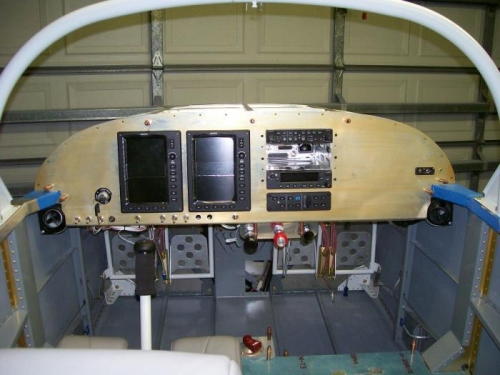

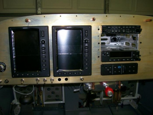

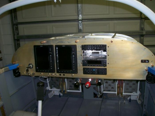

Brief Description:  Panel work
Worked on more panel today. A little more wiring and then cut the panel for the ELT remote and GMC. Alodined the panel and then installed again. Spent a little time configuring the RS-232 for the GTR, GMC and ELT. Every thing is working great. Next I will remove and paint. I decided to clean things up a little. I vacuumed the plane and installed all the panels then put the demo seat back in. Added weight to the baggage area so I could remove the balance weight from the tail. Moved the plane out into the driveway and installed the tailwheel. Took this time to sweep the garage and clean up a little.
