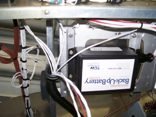

Back-up battery
Found a place to mount the TCW IBBS back-up battery. I mounted it on angle below the GTX transponder. It will be easy to remove or replace later after the top skin is on permenant. Wired it to the PFD and Avioics bus.
