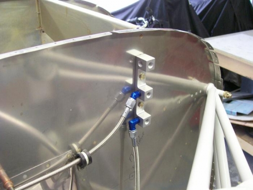

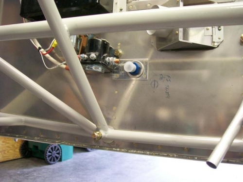

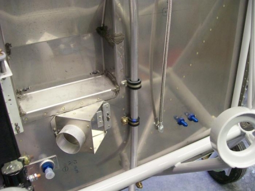

Brief Description:  Firewall small stuff
Started a few of the small things I need to get done before the engine arrives and gets mounted. Mounted the sensor block. Drilled the firewall for the fuel line and added a doubler and fitting. Drilled for a cushion clamp and riveted a platenut to the back side of the firewall. This clamp is for the oil breather tube. Connected the oil pressure hose to the sensor block.
